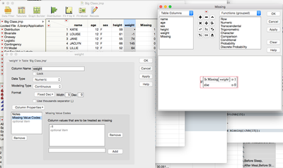

JMP 12 recognizes the missing value as defined by the Missing Value Codes property. The screen shot below is what I get after running your script.
By the way, if you ever want to get the actual value you can use Col Stored Value().
