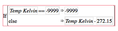

What version of JMP are you using?
We've changed this behavior with JMP 12. Functions in the formula editor now respect the Missing Value Code property. Earlier versions (as you've discovered) didn't do this.
If you want to account for this in your conversion in JMP 11 and earlier you'll need to put a conditional in your formula.
If(:Temp Kelvin == -9999, -9999, :Temp Kelvin - 272.15)
