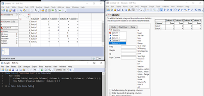

You can use the Tabulate platform to get the table you need.
(Data Table( "Untitled 148" ) << Tabulate(
	Add Table(
		Column Table( Analysis Columns( :Column 2, :Column 3, :Column 4, :Column 5 ) ),
		Row Table( Grouping Columns( :Column 1 ) )
)) << Make Into Data Table

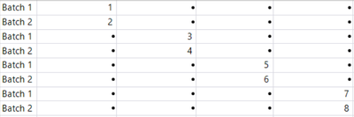

Re: Merging Multiple Tables
Hi Jed,
Thank you for the quick response. That's close to what I'm looking for, but not quite. Unfortunately, that yields a table similar to the one below:
What I'm trying to achieve is more like what's shown below, so that I can use fit model with the data:
	Add Table(
Thank you that fixes my problem!
