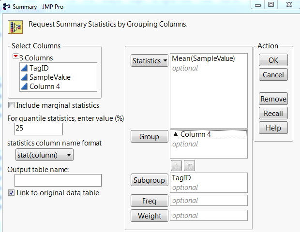

I'm happy with how the table looks. The numbers in the columns are off though. TagID 3322 does not have a timestamp at 4:10 PM, but when I do the mean function a SampleValue is in the 4:10 PM row. For the 4:20 PM timestamp, the SampleValue mean is not correct for the 3322 Tag. It averages the values for one of the 4:20 timestamps and one of the 4:30 timestamps.
Re: Merge data by time stamp
I think I know what's going on here. The first column name is "Column 4 3317" which is not what you should have. There should be just "Column 4". Then you will see a empty value in Mean (SampleValue, 3322).
Please test the following in the table menu "Summary":
Group -> Column 4
Mean -> SampleValue
Subgroup -> TagID
Does that fix your issue?
/****NeverStopLearning****/
KellyK
Level II
That worked! Thank you!
