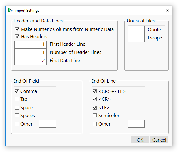

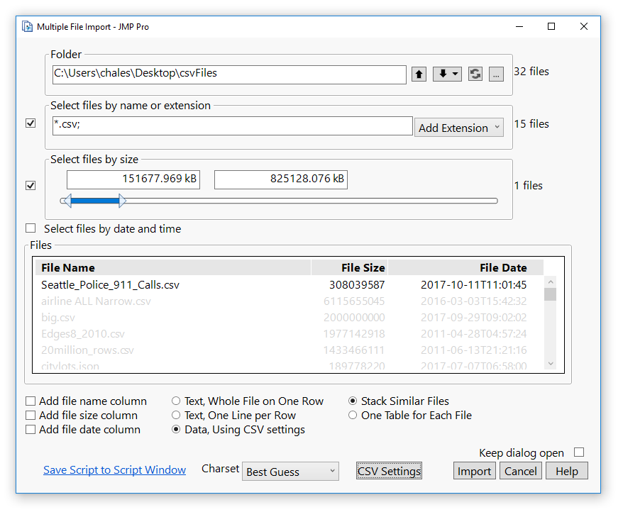

JMP 14 has Multiple File Import. It is designed to load files from a directory and combine similar files (same columns, names). It can load text files into a data table for text explorer, or CSV files into a table using CSV options for headers and skipping some rows.
Choosing files from a directoryChoosing files from a directory
CSV optionsCSV options
