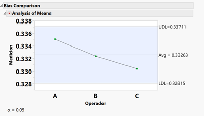

I'm curious why the decision limits for the Bias comparison ANOM in the MSA tool are narrower than those generated by fit Y by X.
From MSA

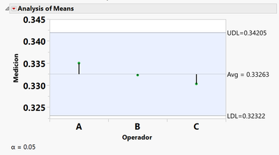

Same data but from the Y/X tool:
The Y/X limits are 2X wider than the MSA limits.
Both charts are using a sample size of 30.

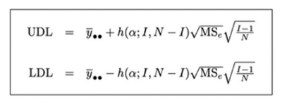

I believe these are the ANOM decision limit equations since they are referenced in JMP help
Alpha level, subgroup size, and within subgroup sample sizes are the same for both charts.
Why would the decision limits be 2X larger on the fit Y by X generated ANOM chart?
