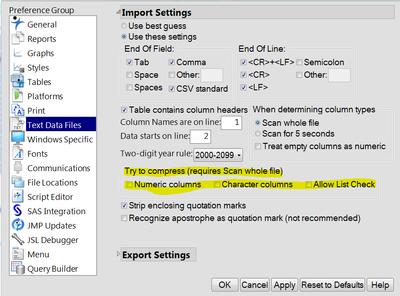

JMP 12 has preferences that may help for importing the CSV.  An extra pass is made to determine which columns can use the 1- 2- or 4-byte integer columns and which character columns have few enough distinct values for list check.
