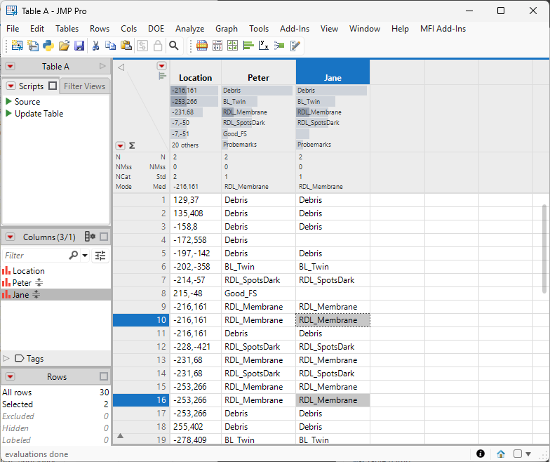

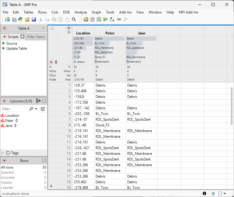

Attached are Tables A, B and C.
Table A has 30 entries by Peter.
Table B has 8,790 entries by Jane.
Table C is the correct joined table done manually.
I want to match the entries by Peter and Jane and create a subset only with "Locations" in Table A, thus Table C.
I had used Table\Join and Table\Update but the results were not accurate.
For example, if you use the Location=-216,161, below should be the output of the joined table ...

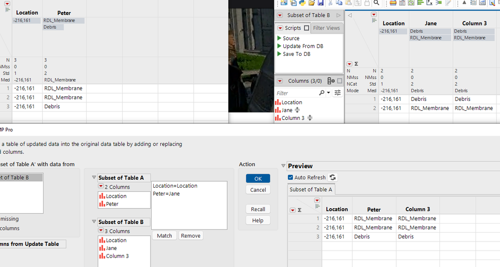

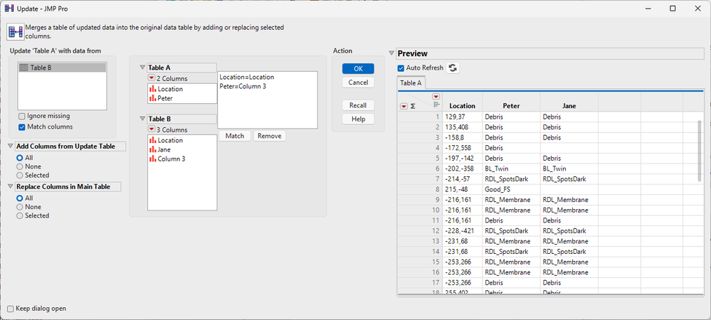

1. Create duplicate column of Jane to Table B
2. Use that new column (Column 3 in my case) as matching column for update
3. Select Location and Jane columns, Rows > Row Selection > Delete Duplicate
4. Select only Jane column (click column header (sometimes you have to hold alt)) and delete those values (press delete)

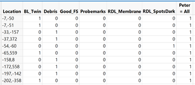

Would you consider first changing the formatting of your data? In my experience, sometimes it is easier to reformat the data into a more analysis-friendly form, rather than to use complex scripting to adapt the analysis to your data format. Having multiple rows corresponding to a particular location (Tall format) works in many cases, but becomes tricky when there are also duplicate observations (i.e. multiple rows that are completely identical). JMP does not always know how it should handle such duplicates, so it may not give you the results you expect when joining.
For example: would you consider changing the format from Tall to Wide? Something like this is common in, for example, semiconductor inspection/test data when there are multiple error categories or yield ranks:
View more...
Local( {obj},
	obj = Data Table( "Table A" ) << Tabulate(
		Add Table(
			Column Table(
				Grouping Columns( :Peter ),
				Add Aggregate Statistics( :Peter )
			Row Table( Grouping Columns( :Location ) )
	obj << Make Into Data Table;
	obj << Close Window;
Resulting in a table like this:
Combining tables in this format for both operators would be much easier.

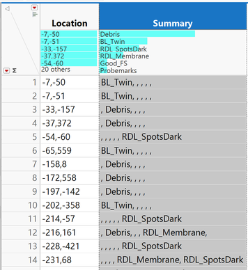

Another option you might consider is the Multiple Response modeling type. For example:
View more...
dt=Data Table( "Table A" ) << Split(
	Split By( :Peter ),
	Split( :Peter ),
	Group( :Location ),
	Output Table( "Split of Table A by Peter" ),
	Sort by Column Property
// New formula column: Concatenate[BL_Twin,Debris,Good_FS,Probemarks,RDL_Membrane,RDL_SpotsDark]
dt <<
New Formula Column(
	Operation( Category( "Character" ), "Concatenate with Comma" ),
	Columns(
		:BL_Twin, :Debris, :Good_FS, :Probemarks, :RDL_Membrane, :RDL_SpotsDark
) << Run Formulas;
dt:"Concatenate[BL_Twin,Debris,Good_FS,Probemarks,RDL_Membrane,RDL_SpotsDark]"n <<
Set Modeling Type( "Multiple Response" );
which looks like this:
