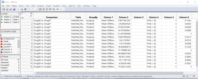

See if this helps you along
Names Default To Here( 1 );
dt = Current Data Table();
colNames = dt << get column names( continuous );
// Start final data table
dtFinal = New Table( "Final", New Column( "Comparison", character ) );
For( i = 2, i <= N Items( colNames ), i++,
	platform = Data Table( "Matched_Pair_by_Group" ) <<
	Matched Pairs(
		invisible,
		SendToByGroup( {:GroupBy == "ProteinA"} ),
		Y( colNames[1], colNames[i] ),
		By( :GroupBy )
	Wait( 0 );
    // Make combined data table
	dtCombined = Report( platform[1] )[Table Box( 1 )] << Make Combined Data Table;
    // Close report window
	Report( platform[1] ) << Close Window;
    // Keep only the Prob > |t| rows
	dtCombined << select where( :column 4 != "Prob > |t|" );
	dtCombined << delete rows;
	// Add the comparison column
	dtCombined << New Column( "Comparison",
		character,
		set each value( colNames[1] || " vs. " || colNames[i] )
    // Add the data table to the Final data table
	dtFinal << concatenate( dtCombined, Append to first table( 1 ) );
    // Delete the Combined table
	Close( dtCombined, nosave );

Tested your script on 133K rows and 10 conditions, and got both Questions resolved.
I did have to edit ProteinA, and will take time to learn what that actually does later.
Thanks, @txnelson !

The ProteinA line is an error.  Just delete the whole line.
