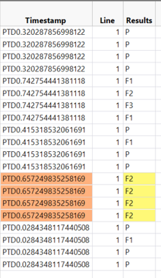

Hello, I have a data table with many columns that I need to review and find a few data points of concerns. I writing a script that will find, color, select then extract to another subset table. My issue is with the find portion of the script. To give you an example, my table has a timestamp record for every data point/cell. I need to find matching cells in timestamp column then look at multiple matching Fails in column Results. The "F2" is just one fail, could be others F3, 4, 5... the key is the matching cells in Results column are same repeating value.

Thanks Jim, I used few select statements similar to yours but not giving me what I need. sorry if I confused you, finding the timestamp is easy.
I need a script that looks at every unique timestamp then evaluate the relevant results and flag if any it is a repeating fails.
In my data I always have 4 consecutive rows with same timestamp. good data should not have the same repeating fail within same time stamp.
as I mentioned timestamp is not static it keeps changing but always 4 consecutive rows will have the same timestamp.
I am trying to automate this since each file I get will have 100k rows in it.

Re: Match cell value in one column to multiple cells in another column
I would simply create a Summary data table, grouping by timestamp and fail.  Then if you search on N Rows, for any value greater than 1, you will have found all of the timestamps with repeating fails.
Jim
Thanks Jim, that actually might work for what I need thanks you!
