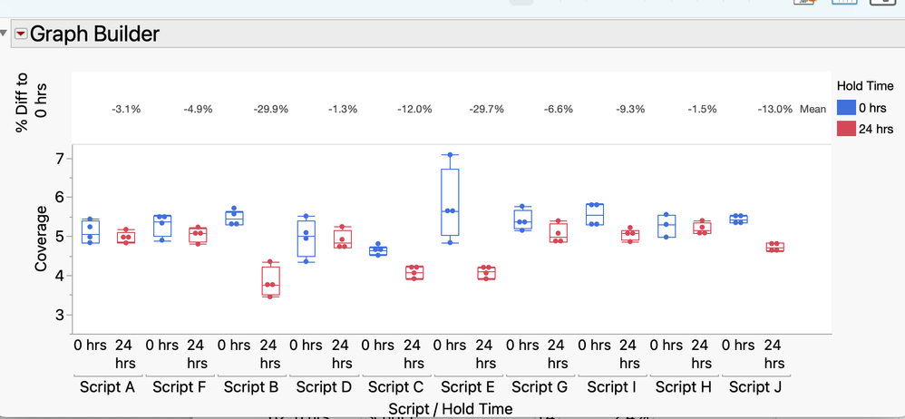

Here is an example where I am calculating % difference between 24 hours and 0 hours for a Script and I would like to mask the 0 hours mean results in the Caption Box since it is equal to 0%. I was able to manually change each text to white by editing but I am wondering if I can do that within the script where I can specify that for each Caption box with "0 hrs" to remove/mask the text. Thank you!!
Before:
After manual editing:
I attached the table with the script in this message.

Result:
