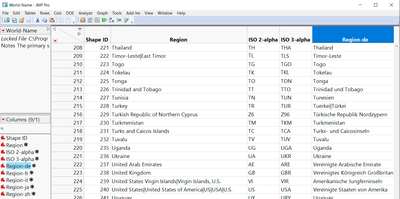

Re: Map Shapes Not Found In Graph Builder ( Great Britain)
You can edit the built-in map shape files to add the alternative names for these geographies.
The map files are in C:\Program Files\SAS\JMP[or JMPPRO]\[VERSION NUMBER]\Maps. So for JMP Pro 16 they are in C:\Program Files\SAS\JMPPRO\16\Maps.
Open the World-Name.jmp file and find the United Kingdom row and add the alternative names, separating them with a | symbol.
