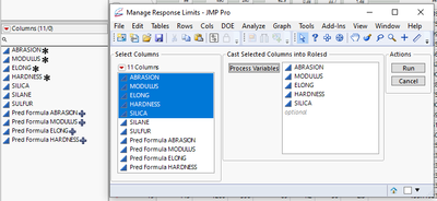

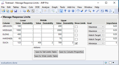

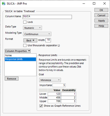

Is there an interest for Manage Response Limits add-in which would work in similar manner as the Manage Spec Limits JMP already has? I would like to to have some very generic add-in/tool which would handle all/selected column properties, but I do not have time to write one at the moment
Here are some images of the possible addin: using Tiretread.jmp as example as it has some existing response limits:
(currently missing option to load settings from Limits Table)

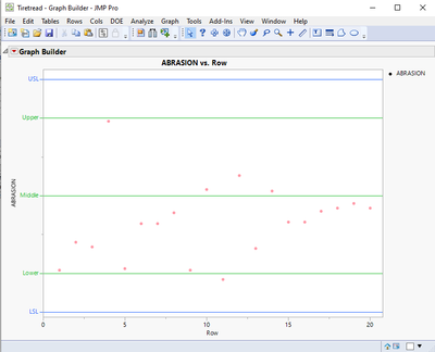

I have mostly used Response Limits column properties to get some quick new lines to wide formatted data in addition to Spec Limits.
