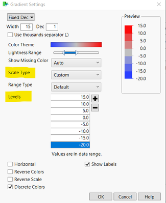

Hi,
The quickest way to do it would be from the gradient settings menu (right click on the colour scale, and select "gradient"). From here, you can set manual levels for the colours. To do this, Change scale type to "custom", then enter in your desired levels, and if you want them to be separate rather than a colour spectrum, then check the "discrete colours" option.
Hit OK, and it should be sorted.
Hope that helps,
