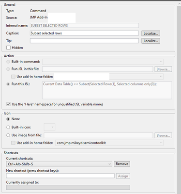

I have created "add-in" (it has many other shortcuts that's why it is an add-in) which basically just sets shortcut to run simple script like
Current Data Table() << Subset(Selected Rows(1), Selected Columns Only(0));
You could also do this by creating a toolbar and adding shortcut to it.

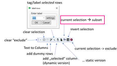

Before creating an Add-In on your own, you might have a look at QuickSelect Toolbar
The option which you describe is this one:
There are many more Shortcut included -  like Tagging (~ Name Selection in Column on Steroids)
... and there is also a Shortcut for Invert selection :)
