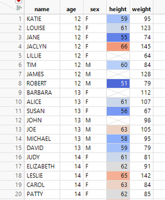

You can activate  Color Cell by value to highlight missing values :
Unfortunately, even if the user doesn't specify colors for the other values, JMP will use some color scale automatically.
This is why this code
Names Default to Here(1);
dt[[5,7,9,12],{height}]=999;
:height <<
	Set Property( "Missing Value Codes", {999} ) <<
	Set Property(
		"Value Colors",
		{999 = "Medium Light Gray", Color Cell by Value( 1 )}
 produces this view:
You can use one of these workarounds to  get transparent missing values - without affecting the other cells:
  • set all the other values to white
use color gradient (from white to white):
:height << 	Set Property( "Missing Value Codes", {999} ) <<
	Set Property(
		"Color Gradient",
		{{"white", {"Continuous", "Categorical", "Diverging"}, {{255, 255, 255},
		{255, 255, 255}, Missing( "Black" )}}, Range( {0, 50, 100} ),
		Color Cell by Value}

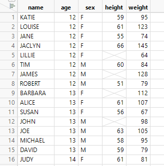

hogi
Level XIII
Re: Making Missing Value Codes More Transparent
Afterwards, the column will have a flag Color Cell by Value.
Unfortunately, applying the flag alone (without a value color - or a color gradient)  doesn't have an affect.
