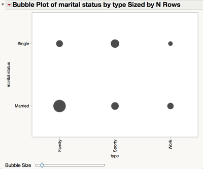

You can do this. You just need to summarize the data first.

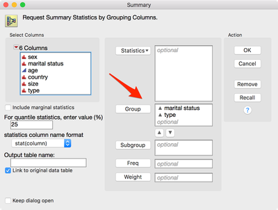

Here's the Car Poll data from the Sample Data.
Then go to Tables->Summary and group it by Marital Status and Type.
which gets you this:
and now, use Bubble Plot with Marital Status on Y, Type on X and N Rows as Size.

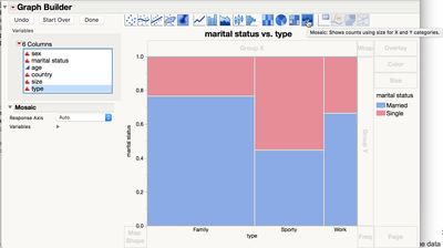

On the other hand, I'm not sure that's the best visualization for this type of data. Starting with the original Car Poll data (no need to summarize) you can use Graph Builder with Marital Status on the Y and Type on the X and use the Mosaic element.

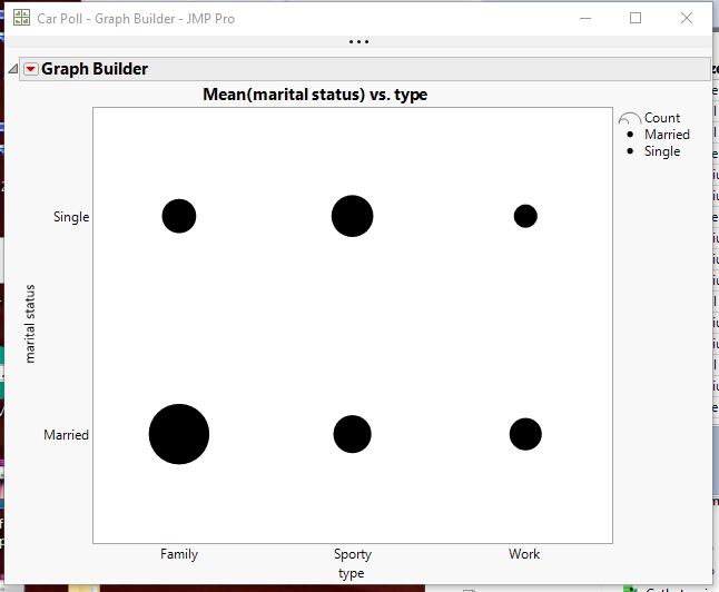

txnelson
Re: Make size of bubbles in bubble plot proportional to count
Here is a Graph Builder Bubble Chart using the Car Poll data, without creating a new data table.  Instead, it uses a Transform variable created within the Graph Builder.
I created the chart interactively, and then used Save Script for the script below.  I did add to the script the first 2 lines.
names default to here(1);
dt=open("$SAMPLE_DATA/Car Poll.jmp");
Graph Builder(
	Size( 534, 450 ),
	Show Control Panel( 0 ),
	Variables(
		X( :type ),
		Y( :marital status ),
		Overlay( :marital status ),
		Size(
			Transform Column(
				"Count",
				Formula( Col Number( :age, :marital status, :type ) )
			Summary Statistic( "Mean" )
	Elements( Points( X, Y, Legend( 8 ), Summary Statistic( "Mean" ) ) ),
	SendToReport(
		Dispatch(
			"400",
			ScaleBox,
			{Legend Model(
				8,
				Properties( 0, {Marker Size( 15 )}, Item ID( "Count", 1 ) ),
				Properties( 1, {Line Color( 0 )}, Item ID( "Married", 1 ) ),
				Properties( 2, {Line Color( 0 )}, Item ID( "Single", 1 ) )
Jim
