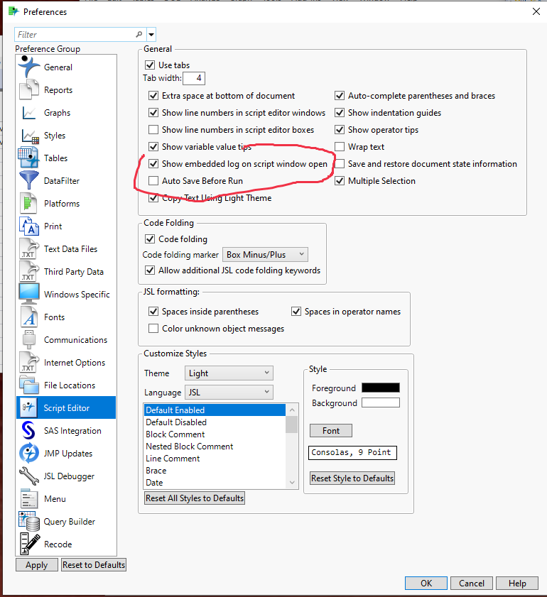

In jmp 15, How to make the log view and script editor in the same window page.
I used to have log view and script editor in the same window, with log session at low part before upgrading to JMP15,
After ver 15, I could no longer to make it, as the log view in the same window of editor is very convenient to the result.
Please advise .
Thanks.
txnelson
Re: In jmp 15, How to make the log view and script editor in the same window page.
Right click in the script window and select "Show Embedded Log"
You can also go to the preferences
     File=>Preferences=>Script Editor
and set the preference so it will start of with an embedded log
Jim
