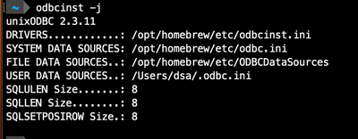

Here are my ODBC settings through unixODBC:
I have symlinks to /etc/odbcinst.ini and /etc/odbc.ini as well.

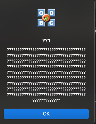

iodbc just shows these kinds of errors when i click test (even if i make a DSN straight out of the documentation):
and JSL will show similar stuff if i try to hit that DSN or driver:
If i hit the same DSN from python and pyodbc it works without any errors... I am wondering if it can be something with the encoding but iodbc or jmp are not really giving me a lot to troubleshoot on.
iODBC is at least not understanding how the driver is working, that's my only conclusion so far.
