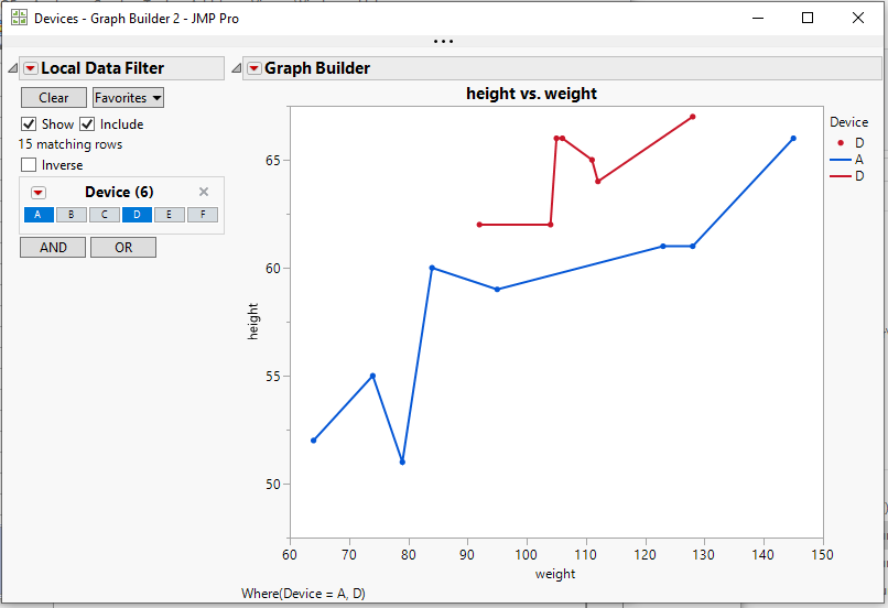

Please paste a copy of the JSL into your response using the jsl.PNGso that the community can just copy and paste into JMP to work on your discussion item.  You can also attach the JSL as a separate file.  Otherwise, each Community member will have to manually retype in your JSL in order to work on it.
You may also want to rethink your approach.  I believe you can get what you want using a Local Data Filter, which would allow the user to Dynamically change the Overlay plot rather than just allowing one setting and then having to rerun the code to make a different selection of devices
