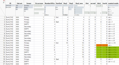

Looking to generate two columns based on some pattern from other columns
Hi All,
I am looking to generate two new columns based on patterns in other two columns ( "Required column1" and "Required Column2"). Please see the attached image -
Any help/suggestion ?
Thanks.

I gave a go with this. I try to avoid using Lag() whenever possible and replace it with Col functions. The most difficult formula seems to be Required Column 1 and I couldn't quickly figure out good formula without using Lag() (there is most likely a solution with Col Cumulative Sum somehow). One idea would be to fill places between Start and End with "Ongoing" or something similar, then you could maybe use Col Cumulative Sum easier, but then the most difficult formula would most likely just move to Start and End.

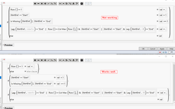

1. What is the difference, If I add more than one condition in single "If" statement vs. Adding more than one "If" statement with single condition. See the attached image - . First case is not giving correct results while the 2nd one is working fine. Results can be seen in the attached sample data. I am having difficulty to understand the differences here.
To me it seems for each row -  in first case, if condition is true, output is given. This ends the results.
While in 2nd case, it will run all 3 if statements sequentially, irrespective of results of previous one and out put will be based on the last true condition. I am not sure if I am able to explain it correctly. Again, I guess in 2nd case (multiple if statement), there is a sort of overwrite on the previous If statement !
2.  There is a condition used in the above formula --  "   Row() == Col Max(Row()) & :StartEnd == "Start"   "   How is it working? It works well, means - it is well written. But I am not able to visualize how the variable/counter "val" stops ?

1. Maybe this image gives explanation why the first idea won't work (if I remember correctly the second solution relies on that if you calculate  . + 1 it will be .:(
I did take the different comparisons from the If statement and just create formulas out of them so it is easier to see what returns True and when.
You could most likely get the first solution working by modifying the comparisons a bit ( Is Missing(:StartEnd) & Lag(:StartEnd) != "End" | :StartEnd == "End", val += 1). But with this change you will have to make small change to second comparison also (add Row() != Col Max(Row()) check).
2. Idea for Row() == Col Max(Row()) & :StartEnd == "Start" is just to to check if we are on last row of the table and :StartEnd value is "Start" we won't set the value as 1 based on previous if statement. Row() will tell you row number and Col Max(Row()) will return you maximum row number in the datatable. Might be a bit unnecessary check because it is last row of table (like the one after it with Start/End), but as it was in the results column, I did implement them.

You can use just one if with multiple comparisons by moving some of the comparisons around a bit (this seemed to return same result as Req1):
If(
	Row() == 1, val = .,
	Row() != Col Max(Row()) & :StartEnd == "Start" & Lag(:StartEnd, -1) != "End", val = 1,
	Is Missing(:StartEnd) & Lag(:StartEnd) != "End" | :StartEnd == "End", val += 1,
	val =.
Hopefully the explanation isn't too messy
