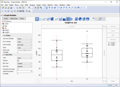

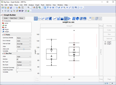

jthi
Re: Locked Columns are messing up script
Could you provide some examples? Images or dataset where it happens. Not sure why locked columns would affect graphic script, but you might have to modify the "index" of lines to start from 0 instead of 1
(1 and 2)
(0 and 1)
-Jarmo
