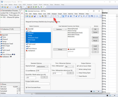

I have an application that contains a 'Filter Col Selector' already.
The application asks the user for Xs, Ys, etc.
I would like to add the option of having a 'Local Data Filter' so the user can remove certain rows from Xs and Ys before running the script.
The option is deactivated on the menu bar and I see there is a 'Local data filter' within the App Builder.
Yet, when I try to add it, this is linked to another data table and I cannot hide it (or collapse it).
What am I missing?

Hi @FN - I think the local data filter in the toolbar is greyed out in this case because the report is not a JMP platform.
I see that the app already has an option to "Omit excluded rows", which I assume is based on data table row states.  Is it a requirement to use a Local Data Filter, or could you use the Global Data Filter to select the rows that you want to keep?  If you switch to a Local Data Filter, the rest of the app logic that determines which rows to include will need to change a little.

I am after something that allows fewer steps. What's a global data filter?
Not using excluded rows is already part of my application, but it forces users to do the selection, exclude rows, use the application, go back to the table, and unexclude them again.
