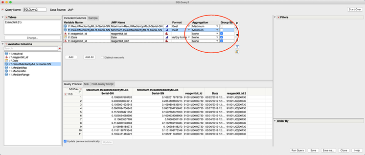

txnelson..you are amazing.  Here is an example jmp file with what I was trying to do.  The much larger table will have 100k more rows so I want to be able to calculate the median range by reagentkit_id.  I am looking for an effect where the result val increases over time.  By subtracting the min date value from the max date value it will mitigate issues were in data between those dates there may be higher values. In essence screen a large data set for instances where the range (max date data value - min date data values in over certain value).  In SQL I can get the min and max calculated for each date but it appears that SQL doesn't allow a max value for max date determination.  I had hoped that JMP would.  But that doesn't seem to be the case.
Jeff_Perkinson
Re: List the value for Max Date?
I'm sure I don't understand exactly what you're looking for. It might help to see the result you'd like for the table you posted.
However, you might find the JMP Query Builder useful. It does have some of the SQL aggregation functions you may be looking for.
