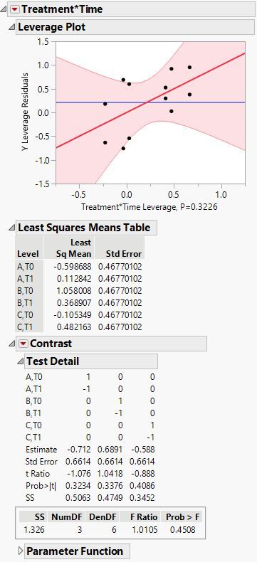

You can use contrasts instead of a custom test, although they are equivalent. I think that the contrast is easier to build and interpret. Set them up like this (mock up of data):

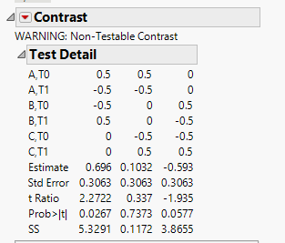

Thanks for your answer! If I understand correctly, in your example you test that the difference between T0 and T1 is significantly different from 0 for each treatment. So if I want to know if the gap T0-T1 is different between two treatments, I need to subtract the corresponding columns?
But I've probably missed something because I get a warning:

Re: Fit Model - Custom Test
Perfect, thank you for the confirmation @Mark_Bailey!
And what does the warning mean in that case?
The individual tests are valid but the joint test is invalid. Just don't use the results for the joint test.
