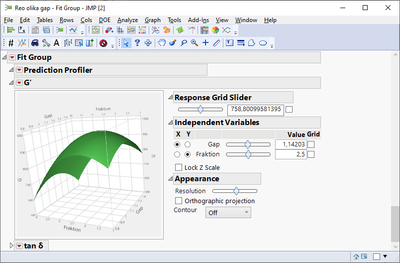

I was using the surface profiler in fit least squares model. Included the data file.
Re: Linking data table with Scatterplot and question in RSM
Thank you for sharing. I am not able to reproduce your results. With your table, running your Fit Least Squares script and adding the Surface Profiler gives me this:
I am running JMP 18.1, if you are running 18.0, maybe updating would fix the problem. If you are already running 18.1, you should probably contact Technical Support to truly figure out what is going on.
It appears to be a difference between running the surface profiler from the Fit Group red triangle or the individual Response red triangle. I'm not sure why that should be the case. As @Dan_Obermiller suggested, you can submit this to JMP Tech Support for further investigation if you like.

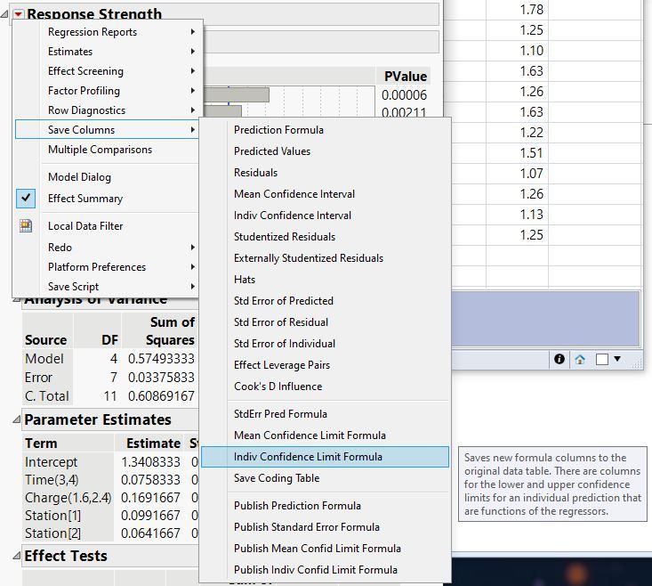

Click the red triangle at the top of Fit Least Squares (the window you show at the start of your discussion) and select Save Columns > Indiv Confidence Limit Formula.

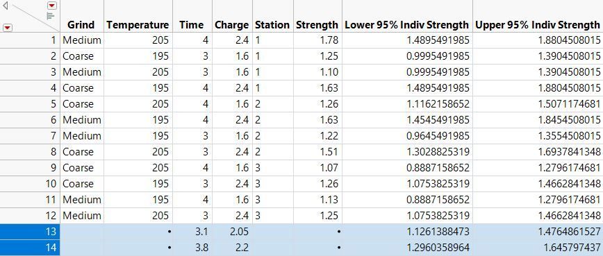

Determine the factor settings for which you want to verify the prediction. I chose settings predicted to yield the optimum and too strong responses. I enter those levels in two new rows of the original data table:
Note the target and tolerance for each condition.
Condition Target Tolerance
Optimum 1.30 0.175
Too Strong 1.47 0.175
The target is the predicted mean response from the Prediction Profiler or mid-point of the individual confidence interval. The tolerance is the half-width of the individual confidence interval.

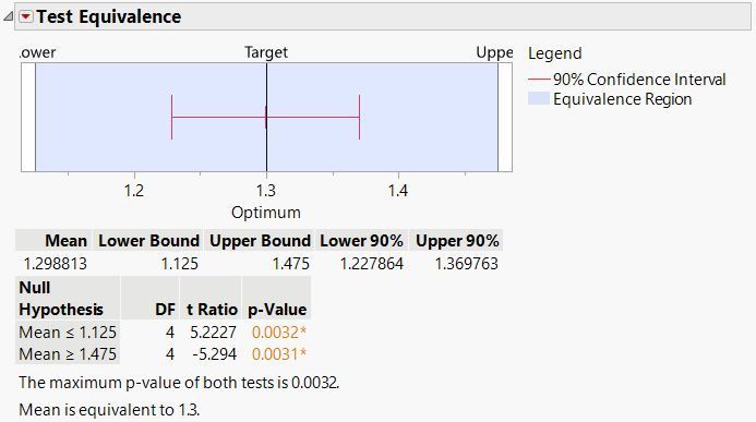

Select Analyze > Distribution and cast both data columns in the Y role. Click the red triangle next to Optimum and select Test Equivalence. Enter the target in the first box and the tolerance in the second box:
Click OK.
The mean is simultaneously significantly greater than the lower limit and less than the upper limit. These two one-sided tests (TOST) demonstrate that the 5 replicates under optimum conditions confirm the model's prediction. Do the same test for the other response.
