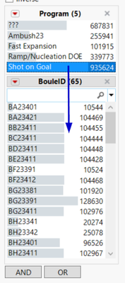

Linking Data filters
How do I link a data filter?
For example, I have multiple BouleIDs in different Programs as shown in the screenshot.
When i select a program, I want only the BouleIDs specific to that program to be visible in the BouleID data filter.
Currently whether I use the AND, or OR conditions, it shows all BouleIDs regardless of what program I selected.
Is there a way to do that without scripting?
This is a basic data analysis platform feature.

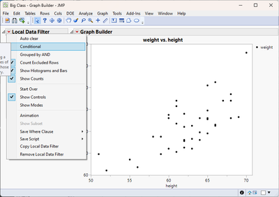

You can set the filter to "conditional" using the red triangle menu.

Re: Linking Data filters
