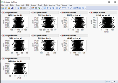

I'm trying to skip a row of charts within the Lineup Box. For instance, instead of a 4x4 grid, I want 4 charts on the first row, 3 charts on the 2nd row, etc. Is there a way to skip a row or add a line break within the Lineup box?
dt = current data table();
//where dtLookup is the data table containing a list of X and Y columns to plot from dt
nw = New Window( "Outputs", lub = Lineup Box( N Col( 4 ) ) );
For Each Row(dtLookup,
	lub << append(
		dt <<
		Graph Builder(
			Size( 500, 350 ),
			Show Control Panel( 0 ),
			Show Legend( 0 ),
			Variables( X( As Column( dt, col_name_X ) ), Y( As Column( dt, col_name_Y)  )),
			Elements( Points( X, Y, Legend( 5 ) ) )

If you know how you want to build the Lineup Boxes with specific column count you could maybe append the lineup box before appending new graphs.
This will break most likely fairly easily as it wants you to have exactly 10 (1+2+3+4) values in dtlookup (using list instead of datatable here).

I am not aware of a "Skip" function for the Lineup Box but there is a workaround that will need a bit of programming involving the insertion of Spacer Boxes (of the same size as your plot) for each slot you want to skip.
However, it gets a bit tricky because you need to skip 0 slots for the first row, 1 slot for the second row, and 2 slots for the third row; you do not need to skip any slot for the last row.
Apologies for the incomplete answer: I don't have the time to work on your script but you might be able to figure it out.

Thank you so much. I ended up using your vlb addition to insert a "page break" based on parsed data from within the column name!
Thank you once again!
