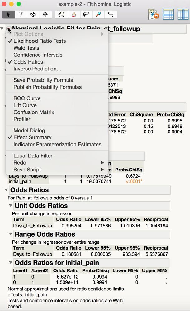

One last question.  In my attached example using the fit model shown, I'm just wondering how to report this in my manuscript as an odds ratio?  Essentially, I want to be able to say, "when adjusted for time to follow-up using a multivariate logistic regression, the presence of pain at initial presentation was associated with pain at early follow up (odds ratio [OR]  X, 95% CI Y–Z, p = ?).  Looking at the output in my data, I'm having a hard time with all of the data that's being spit out to plug it into this statement (my understanding of statistics is rudimentary at best).  Thanks for your help.

You need to answer that question (or Stat formula) with an additional setting turned on in a JMP report.  In both Fit Model and Fit Y by X we can toggle on Odds Ratios under the red triangle to get exactly what you're looking , just right click in that report over hover over items to recieve tools tips.  See annotated images below.
Here is more on Odds Ratios from our JMP Docs
The Library of Medicine has some great content online on this topic. Explaining Odds Ratios
odds_ratio_fit_YX.jpegodds_ratio_fit_model.jpegi
