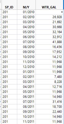

Our goal is to create a 1 month lag column (rather than by row).  The LAG(M/Y) column output of 01/2000 should line up with 02/2000 in the M/Y column, etc.  Attached is a tiny subset example of water use by m/y; whereas, our full table contains more than 59 million rows.   The full table consists of water use for more than 430,000 customers for each each month over many years.  We're open to all suggestions, if using a different column such as CONS_MONTH_NUM is easier or more straightforward.  Could this possibly be resolved using Group By?

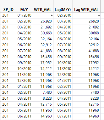

I create a copy of this table, and create two more columns:
The formula for Lag(M/Y) is
The formula for Lag WTR_GAL is the following, which is basically a copy of WTR_GAL.

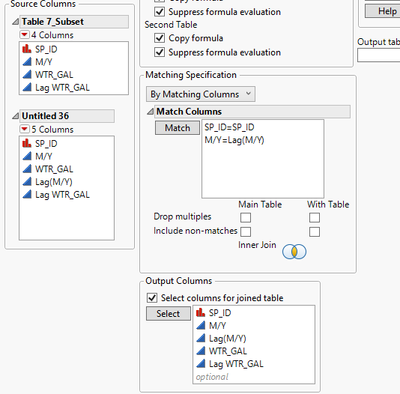

Then I join the two tables together by matching SP_ID and M/Y==Lag(M/Y). Here is the JOIN dialog

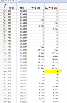

And here is the result
Notice the highlighted cell is something that one has to pay attention if using the row-shifting based Lag. But here, without row-shifting based lag, the result is what I expect. The entire operation is piecing this month data with last month data by JOIN, the result is the same as the "ideal" LAG operation.
