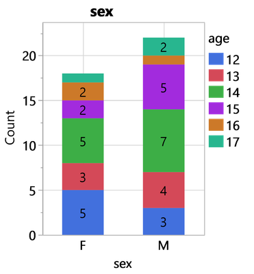

Label by Value: add / remove individual labels
For Heatmap and Bar Graphs, one can add Labels by value.
  • - How can I remove values for a specific subset?
    e.g. just show the labels for pass, but don't show the labels for fail.
  • How can I define that a label must be shown - even if the area is small
    (M, 16y)
Additional question:
How can I change the color of the labels via JSL?
4 REPLIES 4

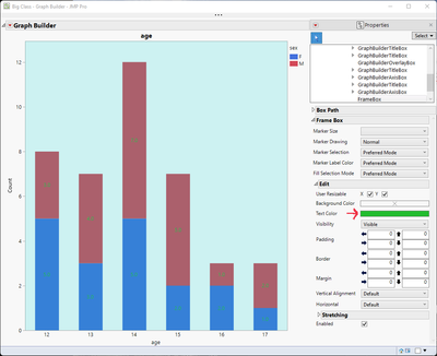

I have half an answer to your third question: you can change the color of the labels in the property editor. This change doesn't seem to be captured in the script for the graph, though.

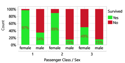

Or wait, cheating a bit, using @Jed_Campbell's reply to the third question :)
Open( "$SAMPLE_DATA/Titanic Passengers.jmp" );
Graph Builder(
	Variables(
		X( :Passenger Class ),X( :Sex, Position( 1 ) ),
		Overlay( :Survived )
	Elements(
		Bar(
			X( 1 ),	X( 2 ),
			Legend( 12 ),
			Bar Style( "Stacked" ),
			Summary Statistic( "% of Factor" ),
			Label( "Label by Value" )
	SendToReport(
		Dispatch({},"400",ScaleBox,{Legend Model(12,
				Properties( 0, {Fill Color( 36 )}, Item ID( "Yes", 1 ) ),
				Properties( 1, {Fill Color( 19 )}, Item ID( "No", 1 ) )
(Current Report() << xpath("//FrameBox")) << {Text Color( "Medium Dark Red" )}

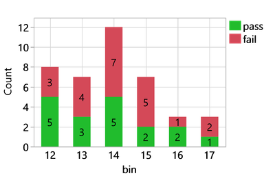

Thanks @Jed_Campbell for the suggestion.
I just noticed a disadvantage of the approach:
the colors of the labels are reset with every change of the data filter:
(the color of the axis stays as it is - even if the axis scale is changed)
Names Default to Here(1);
gb = Graph Builder(
	Summary Statistic( "Median" ),
	Graph Spacing( 4 ),
	Variables( X( :age ), Y( :height ), Overlay( :sex ) ),
	Elements( Bar( X, Y, Legend( 8 ), Label( "Label by Value" ) ) ),
ldf = gb << 	Local Data Filter(
		Conditional,
		Add Filter( columns( :weight ), Where( :weight >= 102.57 ))
(report(gb) << Xpath("//FrameBox")) << {Text Color( "Green" )};
(report(gb) << Xpath("//AxisBox")) << {Text Color( "Green" )};
	wait(1);
ldf << clear();
