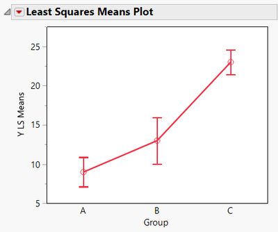

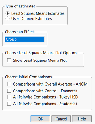

From the red popup for the Response variable choose Estimates > Multiple Comparisons.
You can ask for a Least Squares Means Plot as well as choosing which multiple comparison test you want.

And as Dan was saying yes i knew already how to plot the LS Means from that section. Thank you for that. But that is a simplistic graph and i dont think i can change that in a way that i would format it in the GB.
