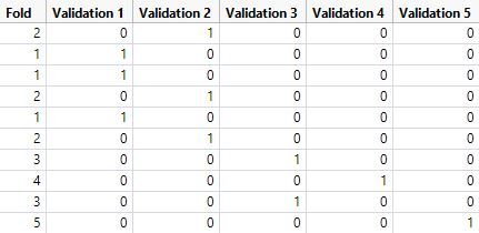

As far as I understand, to run 5-fold cross-validation, I'd need to have five validation columns. Each column would represent the 80-20 split, but where the 20% dedicated for the test in each of the 5 folds is different every time. Is there a way I can do this in JMP?
Re: LDA cross-validation
JMP provides K-fold cross-validation in some platforms but not all of them. You would have to implement your own version of it. Here is one way to do it:
  1. Create a new data column called Fold that uses the Nominal modeling type and with a formula of Random Integer( 1, 5 ). This column will identify the five folds for you.
  2. Create a series of five more data columns called Validation i, also using the Nominal modeling type, and each with a formula of Fold == i, where i changes from 1 to 5 as you go from the first to the last of these new columns.
  3. Launch the Discriminant platform five times using the succession of Validation i columns in the Validation analysis role.
You should have new columns for 5-fold cross-validation in your data table like this.

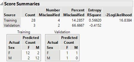

This first iteration of your model fitting might look like this:
Use the cross-validation information for each of the folds, such as:
You can then combine the five sets of results into the overall training and validation results as you see fit such as described in your cited reference.
