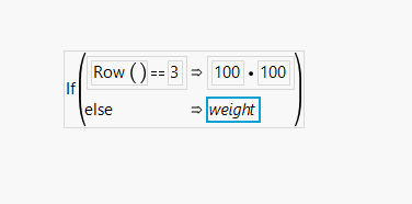

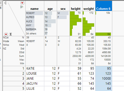

Hey @mukeshkakkey ,
If you really wanted to brute force it, you could use an if statement that would say for a given row return a formula else return the raw data from another column for the rest of the rows.
From the Big class data set:

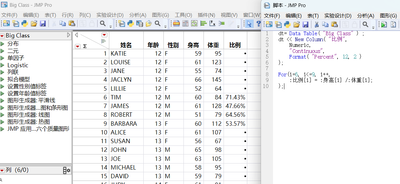

Re: Karkey : How do I use formulas for a single cell instead of an entire column?
可以用JSL脚本,可用于指定单元格计算

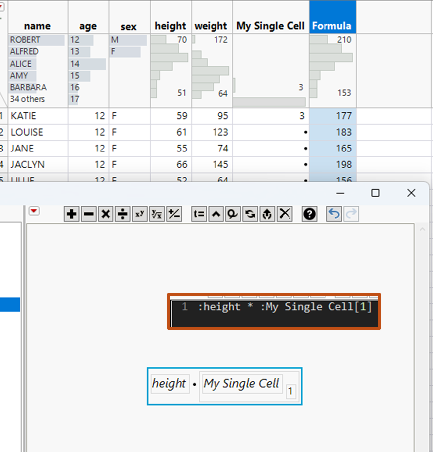

To build on what @lwencx mentioned, you can refer to a single cell in a formula using brackets, as shown below. As @Dan_Obermiller mentioned, table variables are likely a better approach, though.
