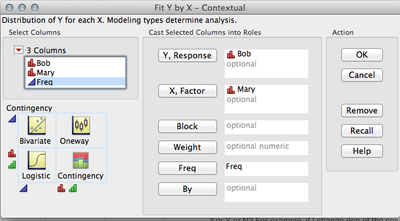

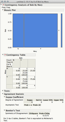

Try adding one more row to your data table with the N for Bob (either Y or N for Mary) and also add a Freq column with a 1 in every row except the new row – with the N in it for Bob – which should have a 0.
Use the Freq column in the Freq role in Fit Y by X and you should get the option for the Agreement Statistic.

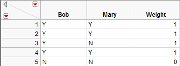

When one of the raters always says the same thing (Bob, in this case) Kappa is zero, by definition. You can show this by adding a weight variable and a dummy observation where Bob says N but with a weight of zero.
