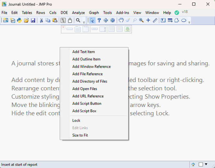

Go to
     File=>New=>Journal
Then right click on the new window and you will see the different actions you can use to build the format of the display

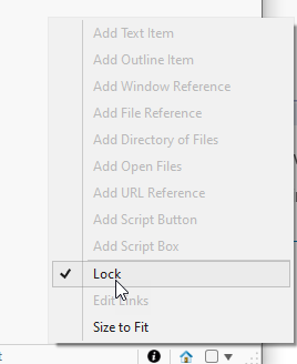

Just use an existing Journal and adapt it to your needs.
If it's locked, unlock it via
