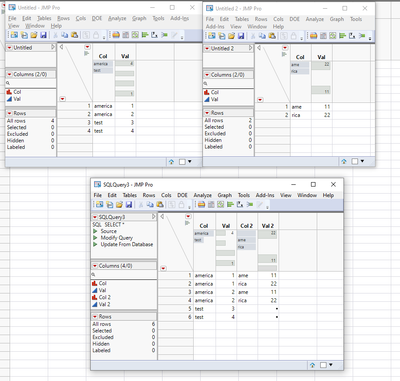

dt3 = Query(
	Table(dt1, "t1"),
	Table(dt2, "t2"),
	"\[SELECT *
	FROM t1
	LEFT OUTER JOIN t2 ON t1.col like '%'||t2.col||'%'
-Jarmo
