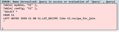

how do I install SQL in JMP?
I keep getting this error:

I think that should work by default in JMP without SQL installations. Which JMP version are you using?

jmp12

It could be that JMP doesn't offer that function, but I'm not sure about that.

The SQL Query functionality was added in JMP 13
The following syntax failed in JMP 12 but executed without error in JMP 13
result = Query( dt, "SELECT * FROM 'Big Class' WHERE age > 14;" );
