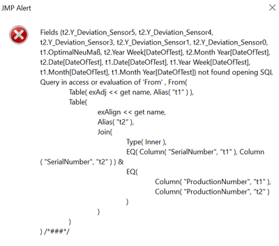

Ich habe mit JMP Query Builder ein Skript erstellt, das 2 Tabellen zusammenführen soll. Das funktioniert auch gut. Jedoch wenn ich das Skript modifiziere, verliert es den ursprünglichen Bezug, was Tabelle 1 und was 2 war.
Das Problem ist Zeile 209 im Skript. Es bleibt an dieser Stelle immer hängen und findet die beiden Tabellen nicht.

Thanks IH, for your answer!
I changed the lines in the script according to your suggestion. But it still doesn't work. In the log I find this remark:
expecting string in access or evaluation of 'exAdj' , exAdj/*###*/
at line 212 in Script.jsl
Line 212 is exactly the line you mentioned in your suggestion. Because of this remark, I have changed the script to the form I showed above first.
Other ideas are welcome!

markus
Level IV
Re: Join Bedingungen in JSL übertragen
Thanks IH
if I introduce your "<< get name" proposal to the script, I get this error message:
at line 211
Any idea more?
Markus
ih
Super User (Alumni) ih
Super User (Alumni)
Do those columns still exist in your source data tables? for example, does the table opened with the reference dtAdj contain the column 'Month[DateOfTest]'?
