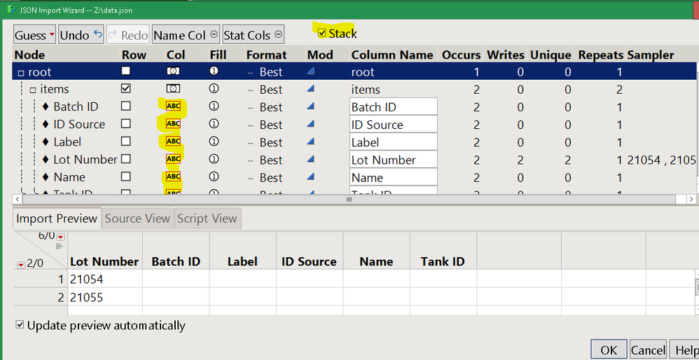

I wrote an answer below that might help, then I realized there is a simple answer you should try first. The data seems to be one of the pandas formats, so change "wide" to "pandas".
If that turns out wrong, try...
Use the wizard to explicitly select the columns, then use that script.
You'll probably want the stack option too.You'll probably want the stack option too.
I also changed the Row generator from root to items, because it is a little more correct. Probably won't make a real difference.
The item selected for Row causes a new row to be written to the data table each time that item occurs. Turn on the Stats and you can see items is what repeats 2 times.
