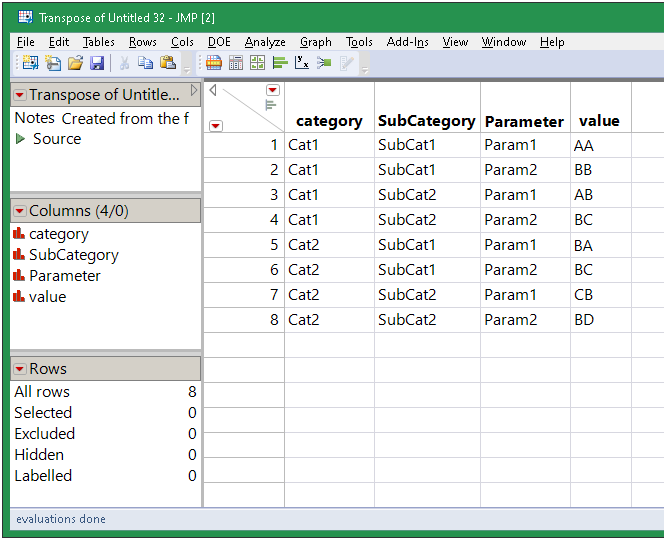

Craige_Hales
Re: JSON <=> JMP
part 1 answer

The import table has the data, in one row, but encoded into the column names. After transposing, use the word() function in a column formula to split the dotted name into 3 columns. Remove the formula so the label column can be removed since it is now redundant.
transposed and column-izedtransposed and column-ized
Craige
