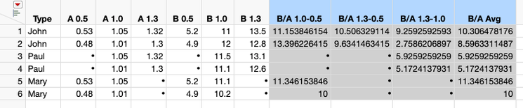

Hello,
I am hoping to get some help on the following:
Attached JMP file with the following table.
My typical/starting data set contain:
1. an identifier "Type"
2. a set of unknown number of columns with same prefix and various number suffix, e.g. A num1, A num2, A num3...
3. a second set of the same number of columns as in #2 above, with same prefix and matching suffix as in #2, e.g. B num1, B num2, B num3...
May I get some help to write a jsl script to generate the columns to pair up the set A and set B column to calculate:
   Formula( (:B 1.0 - :B 0.5) / (:A 1.0 - :A 0.5) ) ),
   Formula( (:B 1.3 - :B 0.5) / (:A 1.3 - :A 0.5) ) ),
   Formula( (:B 1.3 - :B 1.0) / (:A 1.3 - :A 1.0) ) ),
Then, generate an Average column ("B/A Avg") to take the mean of all columns created. Noted that the generate columns above may be any number. It could be 3, or 2, or 6...
At the end of the day, I am mostly interested to get the final column of "B/A Avg", the interim columns are optional if that simplify the script.
Please let me know if I may clarify anything in my questions. Thanks a lot in advance.

jthi
Re: JSL to generate matching column difference and average
What does determine the pairs of columns used for calculation?
-Jarmo
pkl_jmp
Level II
Having the same suffix (number). For example, 0.5 to 0.5, 1.0 to 1.0, 1.3 to 1.3, etc...
jthi
If I have columns A0.5, A1.0, A1.3, B0.5, B1.0 and B1.3, how would I know I need exactly (B1.0-B0.5)/(A1.0-A0.5), (B1.3-B0.5)/(A1.3-A0.5) and (B1.3-B1.0)/(A1.3-A1.0) columns?
-Jarmo
pkl_jmp
Level II
Thank you very much for patiently working with me and apologize for not being 100% clear of the intention.
For the equation, it will always be: ( B num1 - B num2 ) / ( A num1 - A num2 )
Since we will always get the same set of suffix between the A-group and B-group, my goal is to get all possible combinations among the A-group, which can be limited to only higher value suffix - lower value suffix.
Alternatively, if it simplify the script, we may find the difference between any pair, say including both (B1.0-B0.5)/(A1.0-A0.5) and (B0.5-B1.0)/(A0.5-A1.0). This way, the average will still be the same as higher-lower only.

pkl_jmp
Level II
Thank you very much Jarmo. Learned so many new ways of scripting from this example. Appreciate your help.

pkl_jmp
Level II
Thank you very much, Jim, for your help. Very straight forward and easy to understand. Appreciate it!
