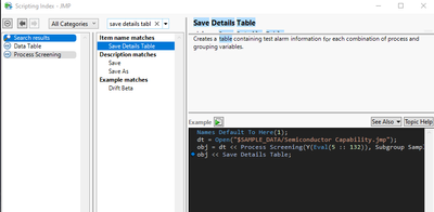

Take a look at Scripting Index (found from JMP Help menu) and search for Save Details Table:
You can get reference of the Details table by changing the last line to:
dt_details = obj << Save Details Table;
and you should be able to save by using that reference
