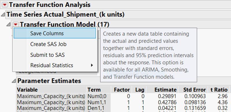

Hi,
I would like to know how to write in JSL script if I want to "save columns" for the first 2 models shown in the model comparison table. Referring to attachment 1 is showing the model comparison table for the first 2 models. Next, in attachment 2 is showing the "save columns" that I want it to open. I want to write both precedures above in script. Is there anyone that can show me?Pic1.JPGPic2.JPG

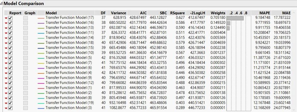

Of course. Below is my solution:
I put all the TFA as a temporary list into the main. Then Make the output result into data table. Since I just want to save column for the first TFA that appeared in the table, I use that TFA number to search back in the temporary list i created in the main and save that into save column.

datatable = Report( obj )[Table Box( 5 )] << make into data table;
datatable << Set Name( "table1" );
datatable << New Column( "Model2",
	Numeric,
	Continuous,
	formula( Num( Regex( :Model, "\D", "", GLOBALREPLACE ) ) )
maxvalue = datatable[1, 11];
dt2 = main[maxvalue] << Save Columns;
dt2 << Set Name( "Result1" );
Column( dt2, 4 ) << Set Name( "Predicted_Shipment_1" );

msharp
Super User (Alumni)
Re: JSL script for save column in the Time Series
Just send the << Save Columns command to the model object.  Here's the example in the scripting index.  Hope it helps!
Names Default To Here( 1 );
dt = Open( "$SAMPLE_DATA/Time Series/Steel Shipments.jmp" );
obj = Time Series( Y( :Steel Shipments ) );
obj2 = obj << Arima( 1, 0, 0 );
obj2 << Save Columns;
ReginaHong
Level III
Hi msharp,
Thank you for your reply but this is not what I want. It is ok because I have found the solution for it.
Thanks alot.
	Numeric,
	Continuous,
