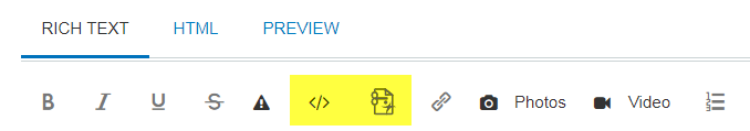

         Welcome to the JSL Community. The community should be able to help you address your problem. However, for your future posts , may I suggest a small thing, when you post code , kindly insert using one of the following options shown below. This will help format the code and make it easier for community users to understand your code and help answer your questions.
