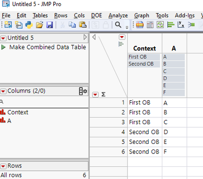

jthi
Re: JSL: <
I assume it is used for something like this
Names Default To Here(1);
nw = New Window("Example",
	ob1 = Outline Box("Outline Box",
		tb1 = table box(string col box("A", {"A", "B", "C"})),
	ob2 = Outline Box("Outline Box",
		table box(string col box("A", {"D", "E", "F"})),
ob1 << Add Context("Context", "First OB");
ob2 << Add Context("Context", "Second OB");
tb1 << Make Combined Data Table;
-Jarmo

Re: JSL: <
Thanks, this is what I need it for.
Matteo
