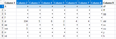

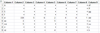

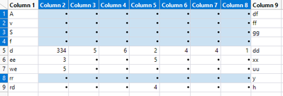

I got error below with the provided. I want to use picture to describe my problem here. please see the next pictures (table) as example. how can I do that with code?
below is my example of the structure of the table. I want to remove empty cell with criteria of only if column2 to column8 are all empty cell. if any of the cell in this range of columns is not empty then do not remove. When I do it with mouse click, I will first (a) highlight first row but only on column2-column8. then I right click to select matching cell (b) and follow with delete (c).

Is this what you are looking for?

dt << select where( Is Missing( Sum( dt[Row(), Index( 3, 11 )] ) ) );
