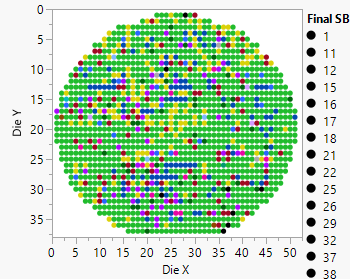

I'm trying to make script which shows row legend with Bin# for the wafer map.
My dataset has LotID, wfID, X, Y, bin info and trying to bring colors based on what we have on original dataset.
Datasets are colored accordingly, but my row legend for wafer map doesn't.

Can someone help me out to match row legend colors with what we have in the wafer map?

I am guessing a bit, but it seems that what you did, was to run your script on your data table
And then specified
     Color or Mark by Column
and selected Final SB as the column to color by
Which gave you
The Legend clearly isn't getting changed as it should.  To work around this issue, just run your script after you have done the
and you will get
Jim
