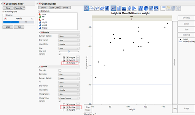

jthi
Re: JSL: add reference lines to Graph Builder Report depending on value of local data filter
If you have reference line table, you could add the reference line column from that to graph builder as Line plot (join or use virtual join to combine data tables).
Example as script:
Names Default To Here(1);
dt << New Column("RefLine", Numeric, Continuous, << Set Each Value(
	If(:sex == "F",
		50
		60
gb = dt << Graph Builder(
	Size(542, 587),
	Show Control Panel(0),
	Variables(X(:weight), Y(:height), Y(:RefLine, Position(1)), Group X(:sex)),
	Elements(Points(X, Y(1), Legend(3)), Line(Y(2), Legend(7))),
	Local Data Filter(Add Filter(columns(:sex), Where(:sex == "F"))),
	SendToReport(
		Dispatch({"Points"}, "", OutlineBox, {Close(0)}),
		Dispatch({"Line"}, "", OutlineBox, {Close(0)})
If this won't work other (there are more than two) would be to use Filter Change Handler to trigger the plotting. See Scripting Index for examples
-Jarmo

HansD
Level II
Hi Jthi, thanks for your fast response and solution - I tried your solutions and it works fine.  I will accept this as a solution.  I will investigate your suggested Filter Change Handler further.  I want to a increase the number of reference lines under certain circumstances.  Regards Hans
