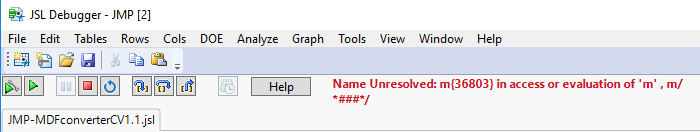

Im still getting the same error, only on the first time running the script, shown below.image.png

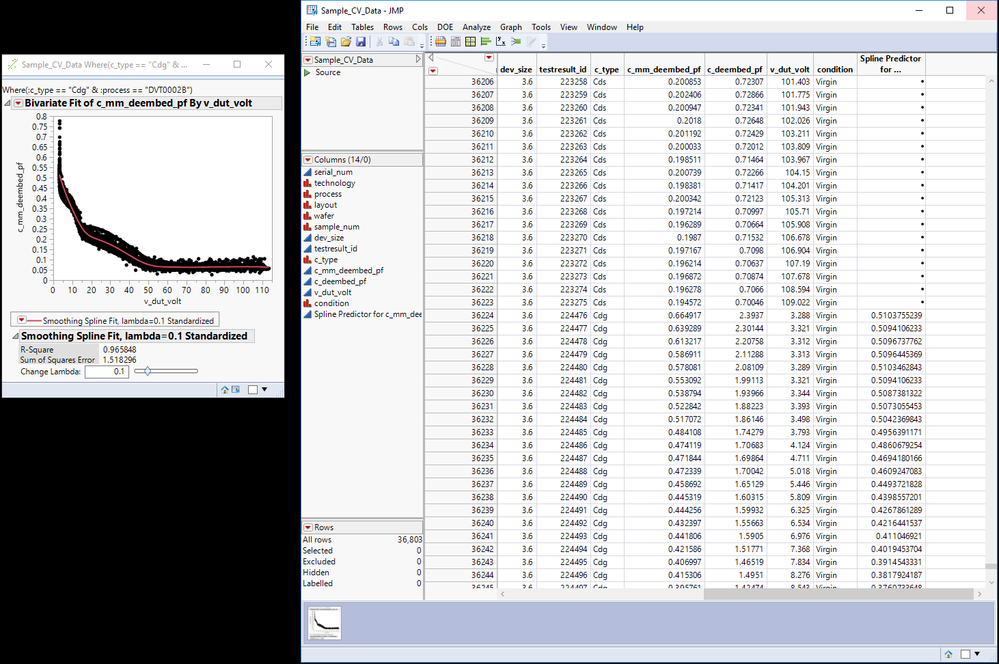

The script even generates and saves one of the splines from one of the :c_type x :process Where-clause combinations, into a new column, before throwing the error.  Implying that it went through one full iteration of the for loop shown below:
For( n = 1, n <= Length( ctypeArray ), n++,
The 1 spline that was created and saved into a new column is shown below:image.png
I am going to try and update to JMP 14, to see if that solves the problem.  I have been using JMP 13.0.0
